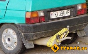

Móking ??
- kolehgrjjeglgkm-skoda1.jpg (16.8 KiB) Viewed 9411 times
